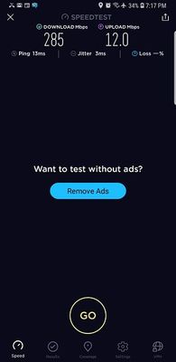

      I am 100% stable at max speeds across both interfaces. I flashed twice and reset as the first time I enabled something and lost 1/2 of my downstream bandwidth over ethernet.  Didn't know what it was, but was determined to figure it out before downgrading.  Fortunately, I didn't need to.  It was "Traffic Meter"
      During testing, I also saw some super slow Wi-Fi speeds.  I was changing channels and letting the radios restart several times in succession between tests.  I saw some horrible wireless performance (less than a megabit).  Using Wi-Fi Analyzer I finally got proper channel selection and things fell right into place.  I found that it was better to restart the router after making a channel change.  So I would change a channel, let the radios restart, then do a reboot, then test speeds again.   I'm provisioned for 280/10 and get 300/12 over eithernet.  I get about 285 down on Wi-Fi.  Very respectable performance and stable.  No issues with 4k streaming either.
