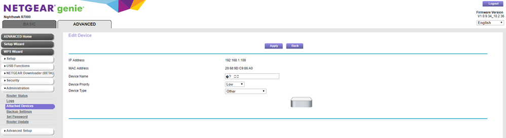

Unable to rename attached device name
After router update (v1.0.9.34_10.2.36), it is not possible to rename attached devices and its type (mobile, computer, etc) in the administration tab. In some cases, when I select a device in the attached device menu and when I select 'edit', weird characters are displayed as device name. If I dont change its type, QoS will have no effect. Does anyone is facing the same problem? My R7000 is set as router.
ps, someone keeps renaming the title to 'Device Name not displayed in Administration Logs', but that is not right! My problem is not with logs, but with attached device name in the administration tap!

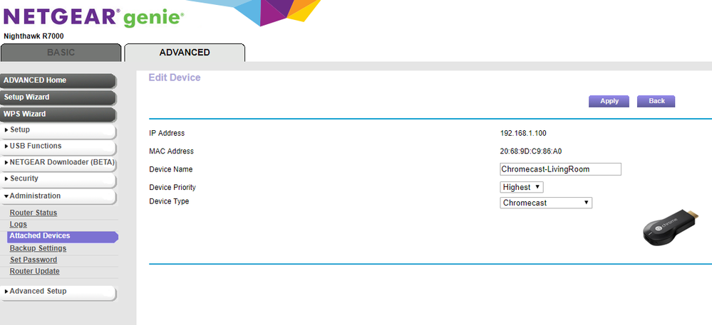

    • rodrigues_lds's avatar
      rodrigues_lds
      Guide
      Shadowsports, you will only be able to change the attached device type if QoS is set as ON (Advanced > Setup > QoS > Enable QoS) on your router. Then, you can establish data transmission priorities by setting the device type and its priority as shown in the picture below:

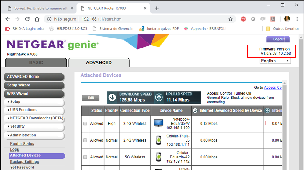

        rodrigues_lds
        Guide
        Jameson, that is weird! I saw an update firmware version available three days ago and I updated my router. However, I opened Netgear website today and for some reason they dropped that version. As you can see in Netgear UI, my router has a newer version:
