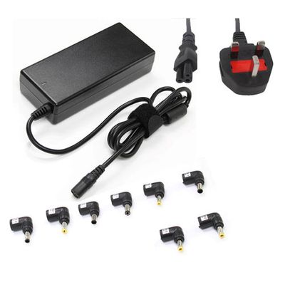

    Netgear does not sell replacement power adapters in most markets. Any generic transformer will work, as long as it has the right volts, enough amps and a tip with the right (+/-) polarity and dimensions. (Look at the label on your device or the old adapter.)
    The details you need should be on the old adapter, on a label on the device itself and in its manual.
    You can find suitable adapters in all the usual places. Some will even list compatibility with different Netgear hardware.
    Some generic adapters come with a set of tips that will fit a range of different devices.
    Generic adapter
    Does you US adapter have the specifications on it? The manual for the RS700 says that the adapter for North America is "100-240V, 50/60 Hz input".
    Many are 120/240 volt and you can just use an appropriate adapter to plug it into the wall socket.

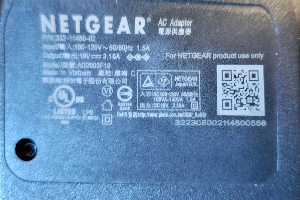

  • Was asked to post the picture of the power plug end and the socket on router so here we are... no pin in the middle of the plug.

      Yes - depending on the wording, to some users the inner connector (where the small additional contact for the additional always-on power for modems and WoL is located) does look like a large center pin (reversed) to the common DC barrel plugs. This is where the confusion is coming from - leaving alone I have not seen these on standardized power supplies yet - what can make it difficult to locate third party alternate power supplies.

      Thanks jessejames87 for posting that. Confirms it's the larger center pin as I suspected. I see the pin is (+) as well. Glad that's still standard.
      So maybe possible for the RAXE500 PS that could be compatible. Can you post a picture of the PS label from the RS700?
      • jessejames87's avatar
        jessejames87
        Apprentice
        not the best photo but legible.
