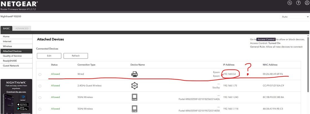

My Workforce 60 printer which has 10/100 port is stuck on wrong port via wireless which I cannot see, I've try with "Epson Net config port software" but cannot see this printer via wireless, would connecting it to the 10/100 port might help you think?
- Aurion64Aspirant
See photo.
Network sheet.
IP Address 192.168.0.4
Subnet Mask 255.255.255.0
Default Gateway 192.168.0.1
When my gateway is 192.168.1.1? - Aurion64Aspirant
Cannot get it to setup under 192.168.1.1 gateway, as the wireless in on the wrong ip address for this router?
Would pluging in the old router then using the "Epson Net config" to alter the ip address over to the right gateway and just pick 192.168.80.1 for printer would do, this is what I'm thinking of doing?
As we cannot use the wireless of this printer, and only can use via a usb cable. - Aurion64Aspirant
