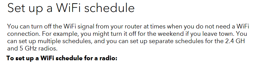

    (it appears that perhaps the RS700 User Manual was not updated to reflect that this product has a 6GHz radio.  See page 78 of the user manual)
    https://www.downloads.netgear.com/files/GDC/RS700S/RS700_UM_EN.pdf
