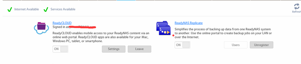

I have 2 ReadyNASes that were previously connected to a ReadyNAS replicate account. I factory restored one of the ReadyNASes then took the other off the ReadyNAS replicate account because I was having issues.
NOW I can't get reconnected. I verified that the log-in credentials work fine. If you refer to the pictures below, you'll see me logging into the ReadyNAS account with my credentials.
But, when I try turning on the ReadyNAS Replicate feature on either of my machines, its a no go. It simply tells me that I don't have the correct credentials:
If anyone has any suggestions, let me know. Please keep in mind that I VERIFIED that the credentials are working to log me in directly to ReadNAS replicate as shown in the pictures above.

I'm wondering what the resolution was to this issue. I am having (what seems to be) exactly the same issue. I'm running 2x RN312 2-bay units and have decided to upgrade the storage from 2x2TB to 2x4TB. I have one chassis upgraded and now neither will connect to Replicate. Which is a shame because I **love** Replicate. It has worked flawlessly for me for years between the two chassis'.
Reason I say it feels exactly the same is:
1) I can login successfully to replicate.readynas.com
2) When I login I get the same message that I have no devices connected to the account
3) When I login to the device admin screen, all appears 'green' (connected to internet etc)
4) When I attempt to switch on 'ReadyNAS Replicate' and enter the account I get a "User name or password is invalid" message. I am totally sure I am using the same username and password. I have even tried copying-and-pasting the same text in to each login just to be sure!
Appreciate any thoughts on resolution please.

1) I did try the 8.8.8.8 DNS setting, but still couldn't get a connection.
2) I did get the 'vanilla' backup working (in the admin account, under the "Backup" menu by just creating 'Jobs' (not even ReadyDR)
3) I ended up creating a new Netgear Remote account and reconfiguring everything to connect to the new account
4) This wasn't without some perplexing things that worked as expected and others that didn't, but using the traditional "reboot and try again" method got through all the perplexing situations.
So now I have a new Remote account which the two boxes are successfully connected to and a successful "Replicate" schedule that has been working for 24hrs without any dramas.
I'm back to where I wanted to be and the family has a solid NAS with a reliable backup.
Success!
