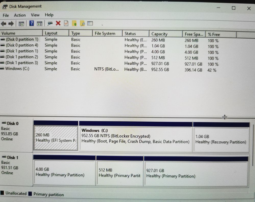

Is there any way I can read the files on each of the drives and transfer them to a windows laptop?
I have a sata to usb attachment which connects the drives and they show up in 'disk management' with 3 partitions but each one shows that it has 927gb of free space. (image below, disk 1 being the drive from the NAS)
I'm guessing these drives have a different file system so what would the best way to view and transfer the files on the drives?
Many thanks.
No, that is not free space. Windows is showing all the partitions as "free space" because it does not recognize the file format.
- Partition 1 is the OS partition (linux and the NAS application)
- Partition 2 is for swap
- Partition 3 is your data volume
