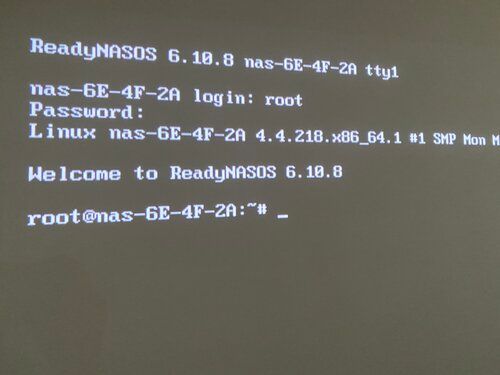

      I've connected the RN316 to HDMI, then i've turned it on, this page comes up on the screen which I can login to:
      I'm not sure whether this is the right place, i've then entered the username and password and i've been told to try pushing F1, F2 or the DEL key, these don't do anything and I don't think i'm doing this in the correct place.

        Update: You have to power on the ReadyNAS, right after pressing the power button, start pushing the DEL key on the keyboard, i pretty much did it repeatedly, the device will output the BIOS screen through the HDMI
