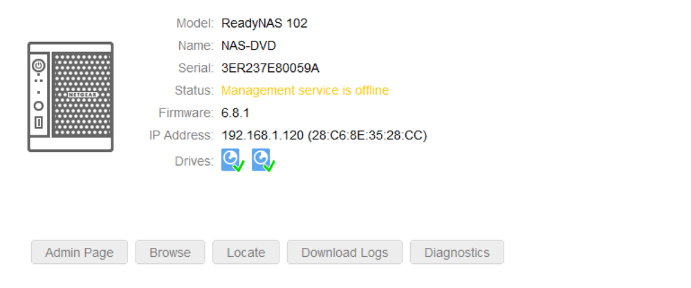

Hi,
I have been using ReadyNAS for a while now, I have four in total and they have been 'almost' flawless.
This morning, however, when I turned one of them on, the Power light continues to flash indicating an issue.
Ran RAIDar 6.3.0 and it tells me both drives are healthy but that the Management Service is Offline.
SSH is not enabled on the device currently (i don't run with SSH enabled).
I was, however, able to download the logs using RAIDar. I tried to upload them for convenience but zip files are not allowed.
Upon searching the forums the most common suggestion appears to be a full O/S partition... but that doing a re-install of the O/S from the boot menu does not fix the issue.  I have not yet done this and would prefer not to perform a factory reset unless we have to.
any assistance in getting my admin page back up and running would be appreciated. Many thanks.

RAIDar output
