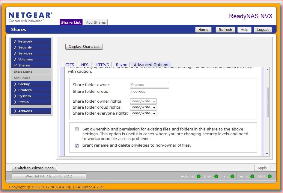

3. Here is the advanced options tab on my NVX. As you can see it is set to nogroup (which is the default, even on x-86 units).
4. Since I no longer have access to an NV+ to experiment with, I was trying to find out what all the setting were. After all Frontview is fairly similar across the platforms. Perhaps if you could take some screen shots and post them, it would be helpful in diagnosing the situation. - iposnerAspirantI've rolled it back to 4.1.8
