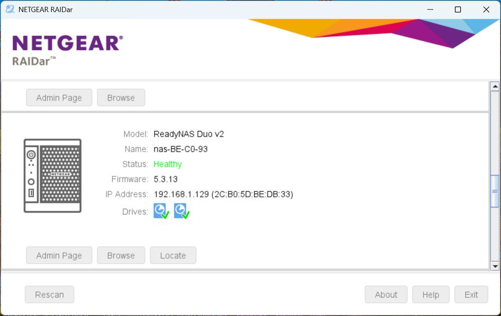

As you can see, from the screen print below, The Name is from the failed (2012) original RNDuoV2, which contains part of it's primary MAC address, and IP Address with the MAC address (in brackets) from the recently bought hardware.
I believe the problem is probably caused by this RNDuoV2 now has two MAC addresses, one from the original failed device, i.e. this number is embedded in HDs, and the second MAC address is part of the new (old stock) RNDuoV2's hardware that is now housing my original HDs.
So I'm guessing that if both MAC addresses can be consolidated into one then the problem would go away.

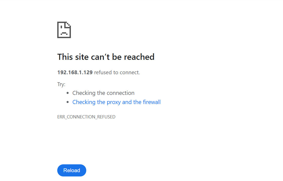

I get the following error message, and similar messages from other browsers (as seen in the attachment), when ever I click the Plex icon or type the URL directly into my other browsers.
    No, that isn't it.
    The most recent version of Plex for the Duo v2 was released back in 2015, so 11 years out of date.  There are lots of potential causes here, including Plex simply crashing due to running out of memory or some other problem.
    Probably the best path is to run a Plex Server on a PC instead of the NAS (keeping the media on the NAS).
