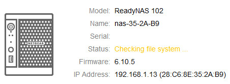

Today I decided to do the USB recovery after which the unit powered down as expected.
I powered the unit up but now it's stuck at 'Checking file system' and it has been stuck at this Status for more than 2 hours:
Obviously, because I did a Factory Reset prior, I have no SSH access anymore.
Any ideas what could be going on and how to fix this?

Hi Stephen,
Thank you for the suggestion. I did that. I removed the disks from the NAS and connected them to my Windows laptop (with a USB to SATA dock).
From there I removed the partitions and re-formatted the disks.
After installing the disks back into the NAS, I entered the boot menu and started Factory Default again.
Guess what? All good now! The NAS is back online and good to go! Jeej!
Thanks so much! Very happy this worked :)
Problem solved!
