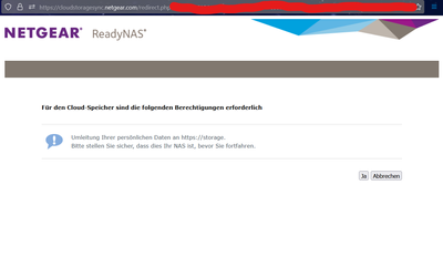

  • in the popup window, supply my MS credentials (https://login.microsoftonline.com)
  • confirm that https://storage may receive my personal OneDrive data (if I do understand that correctly - see first attached screenshot):

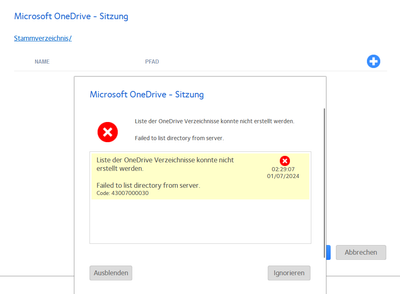

  • next, I try to add a session, but when browsing the OneDrive location, I get an error:

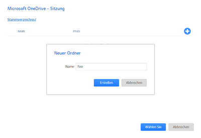

  • I can ignore the error, see the empty root folder and add another folder (called "foo" for testing purposes):

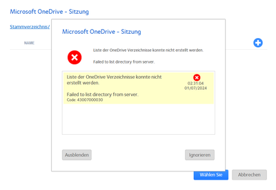

  • After that, I still receive the error that tells me I cannot list the direcrory from OneDrive:
  • An interesting observation, however, might be that the folder "foo" has indeed been created in OneDrive (which I can see in the online version):
