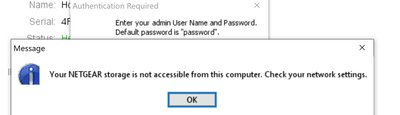

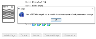

Ran Raidar and it found the NAS on showing the correct IP address, but each time i clicked on one of the options i get a message saying "Your Netgear storage is not accessible from this computer. Check you network settings".

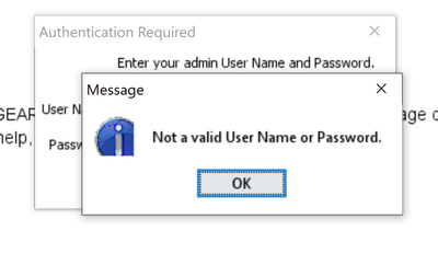

      Have just tried to selecting download the logs and diagnostics. Both prompt for user name and password but when ive tried both the default password and the one i set i get the original message about "storage not accessible" from this computer followed by ""not a valid user name or password".
      Have included a few screen shots just in case there is something really daft i am missing

        The username is admin, the default password (as you know) is password.
        You can also try directly opening your browser to https://nas-ip-address/admin (using the real IP address of course).
