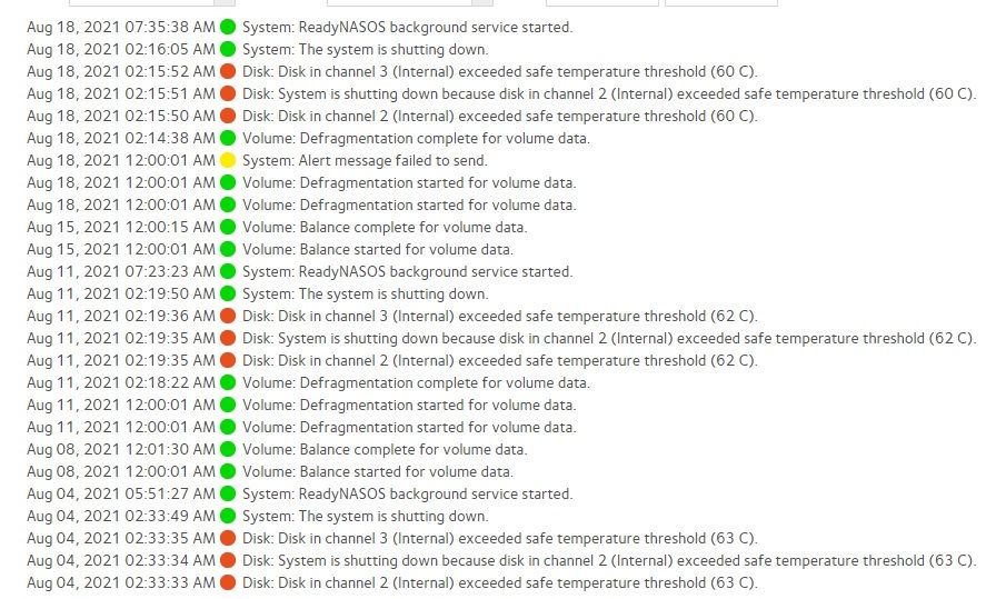

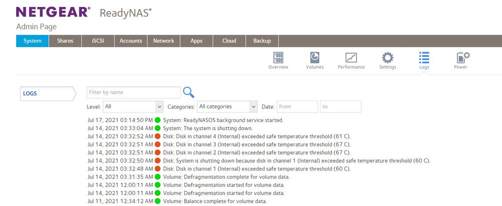

        StephenB So after a couple of weeks, i got the idea of what is causing the issue.  it seems to be immediately after the defrag completes (not sure why I posted nothing was using drives above, I guess I forgot).  It also appears that all the disk drives get too hot.  Originally I had a scheduled rclone doing something at 2 on wednesdays, but I moved that to thursdays.  The problem stayed on Wednesday.
