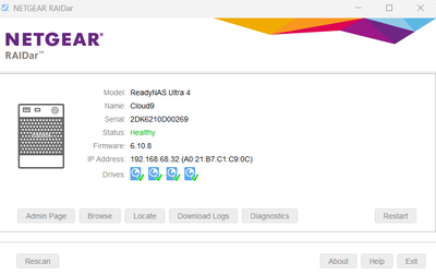

      Here's the raidar snip. I can ping it and it shows on my router list.
      Just can't access the admin page, it gets to the Netgear screen and sits there. Can't access via pc or android file manager.

        Thx - looks like it is also converted to OS-6.  So Netgear would deny support in any event.
        Do you have a backup of your data?
        Are either the download logs or diagnostic links working?  If you can get the logs, then I could take a look at them.
