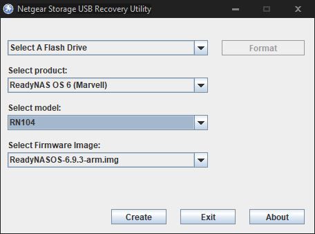

RN10400 ReadNAS 'Booting...' [SOLVED]
Model Number: RND-4D
Model Name: RN10400
The unit only says 'booting' and doesnt' nothing else with or without drives.
Trying to flash it. I downloaded both 'ReadyNASOS-6.9.3-x86_64.img' and 'ReadyNASOS-6.9.3-arm.img' and tried both one at a time. USB
I assume i'm
supposed to use ARM? since that's all that shows on the download page. I get to the USB boot option but unless I failed to read the steps it doesn't say how to boot from this model.
My steps:
-Turn off
-Hold 'backup'
-'Boot from USB' displays on the screen'
what next?
The USB starts flashing but nothing happens.
edit: Used another USB and pressed or held 'backup' and it worked.
1 Reply
- mdgm-ntgrNETGEAR Employee Retired
The RN104 is an ARM unit. It can't run the x86 firmware. Similarly the x86 models can't run the ARM firmware.
Some USB keys are incompatible.
