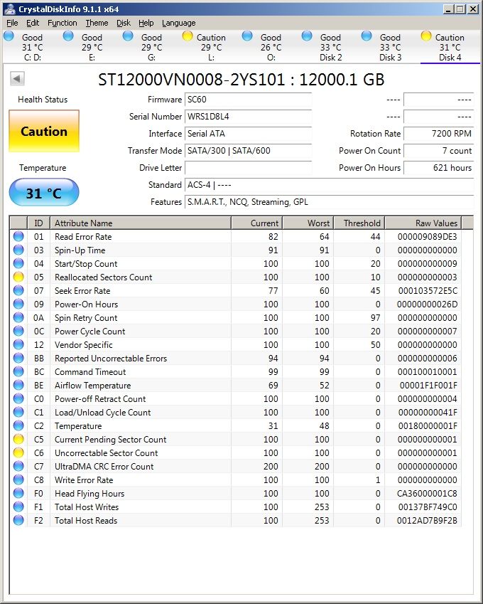

      Anyway. Backed up the data which still was on the 12TB on the PC (on 2 of the 8TB from the old array ), and backing up the data which is on the NAS in the DEGRADED array on the other 2 8TB disks. I took off the FAILED disk, put it on the PC (see CrystalDisk Info below), updated and opened SeaTools, it PASSED the Quick test, currently running (70% done) the”Long Self Test” . Which other test I should run? SeaTools (5.1.249) has three Extended tests (Long Self, Long Generic and 2 Minute Generic) and a “Fix All” menu ( Short and Long) which I presume could exclude Bad Blocks.

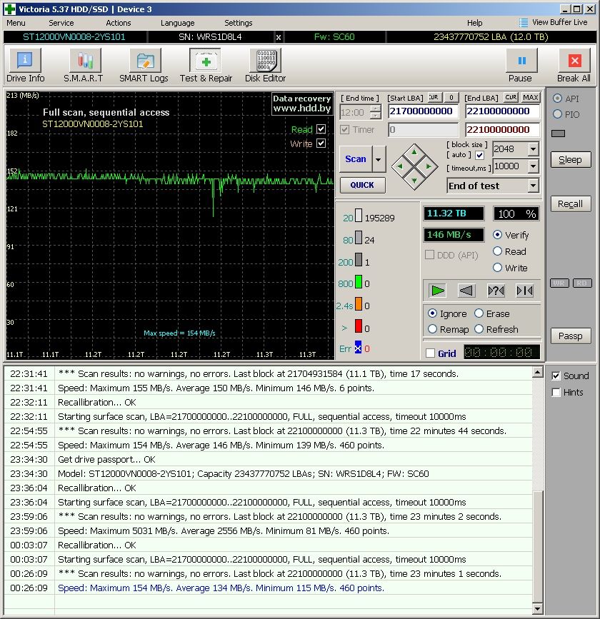

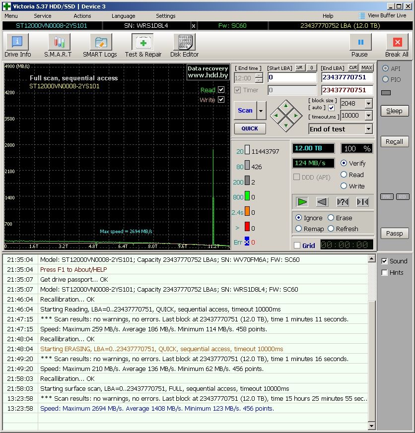

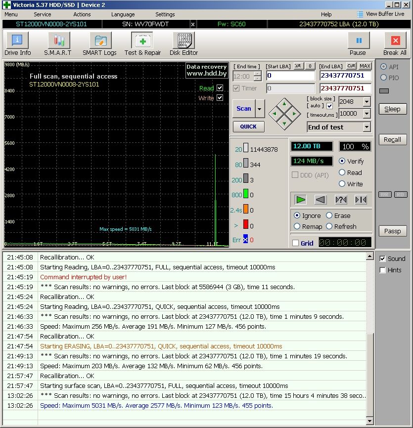

      I tested all the four 12TB with Victoria 5.37. The disk which failed (Serial xxxxD8L4) showed a very strange Read - Write graph with a Read SPIKE of 2694MB/s. I re-tested the drive on a shorter LBA, 217e7 to 221e7 and again had two spikes (5031MB/s !!!), I repeated it, no spikes, tried slighlty different intervals 215e7 to 220e7 and 220e6 to 225e7 , which again showed no spikes, and concluded that the spikes were aberration caused by something else ( the PC was also Recording and Saving streams using VLC, maybe that cause an I/O delay somewhere which was seen by Victoria as a spike – which is weird anyway, a conventional HDD CANNOT read a block at 2000MBs or 5000MB/s.
      I am mentioning this “odd” behaviour, because the disk in Slot1 ALSO showed a spike during testing……
      Disk currently on NAS, Slot 1
