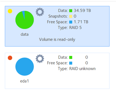

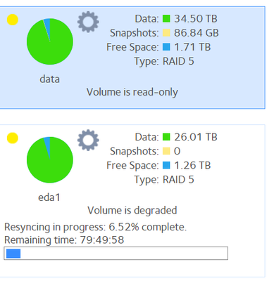

  • Dear All,
    I have finally succeeded to save all data and EXPORT the EDA extension device.
    After disconnecting it I have reboot and the Read-Only Status disappeared.
    And it's possible to add/remove files.
    Then I have shut downed the system and reconnected the EDA module, restarted it and bad news : the main volume (on the RD316) got again the read-only status.
    It seems that the connection with the EDA device generates this status.
    I don't know what to do ....
    Do you have some recommendations to fix this issue?
    Thanks for your support

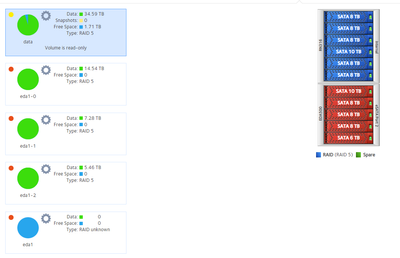

  • Dear Sandshark
    please find my answers in your text
    If you disconnect the EDA (power off- -- don't export) is the main volume still read-only? ==> YES
    The NAS will complain about the missing volume, and will need to re-sync the OS partition of the EDA drives when you re-connect, but the volume should be fine so long as you are connecting to the same main volume.
    After that I have shutdowned the main device and startet it again, booting is stuck at 25% for 2 hours .... no progress
    You can try using another eSATA port. I believe port 3 (the red one) uses a different controller than the other two and the main drives.
    ==> There is no red one port and I've tried to use the second one without different result
    eSATA is the Achilles heel of the EDA500. If disconnecting doesn't clear the read-only flag of the main volume, you'll have to export, make a new one, then try connecting to another port. Maybe try with a single-drive main volume before all drives and RAID sync of the main volume.
    still waiting for end of booting ....

      The first picture is with the EDA removed and the second is after it was re-connected with power off and then powered on?  Then you re-booted and it doesn't even get that far?  That would tend to indicate that the EDA volume had a problem before it was removed, but it didn't show up.
