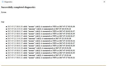

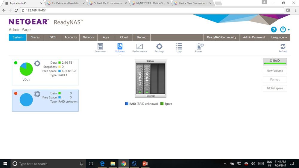

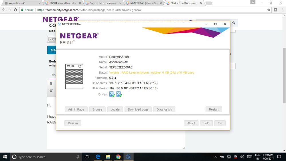

I have installed a 2nd Disk on my RN104. This shows a red dot next to the 2nd disk and the RAIDar show that the Volume Level Unknown, Inactive; 0 MB (0%) of 0 MN used. Also enclosed herewith the Daigonstic Screen from RAIDar. Kindly help.

    Data is 0 and it is an unknown volume, I guess you can destroy it by clicking the gear icon of it and click destroy, you will be prompted to type the word DESTROY.
