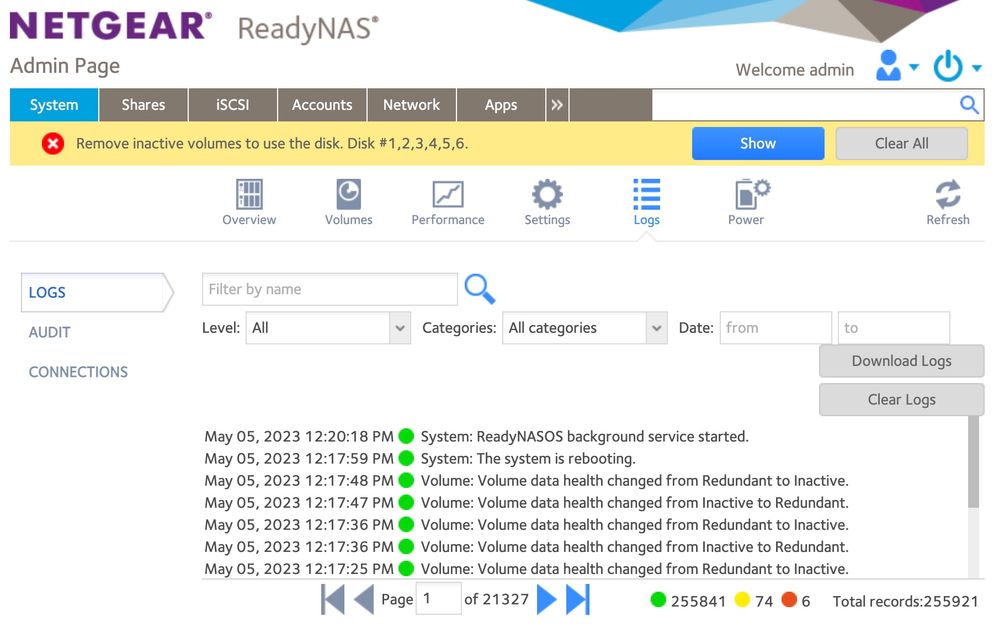

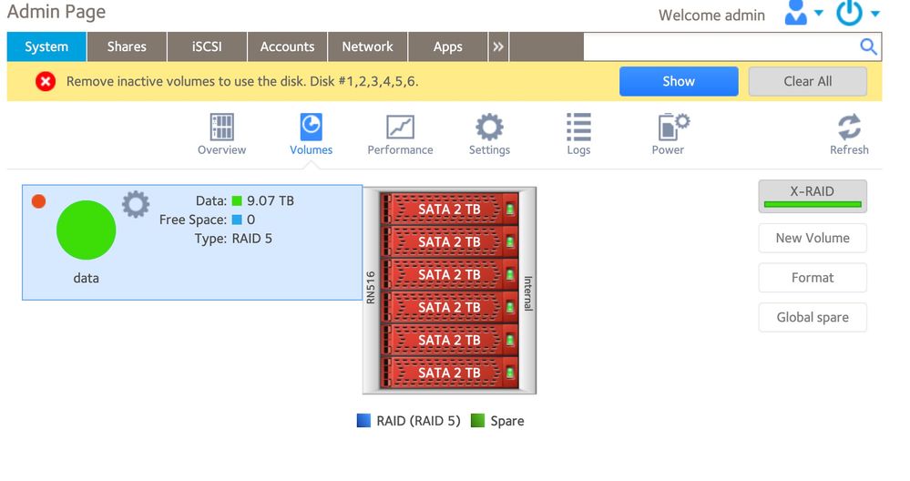

  • Things have gotten worse - perhaps as a result of my meddling prior to reading your solutions.
    And my logs have just blown up with the following pair of warnings:
    When i run `mnt` command in CLI, i don't see any of my subvolumes that I *used* to have:

    I now have a big enough external disk but can't access the data AND the NAS was not able to recognize the 5TB drive when plugged into the USB 3.0 port in the back...
    SO much headaches...
    Any ideas on proper command for remounting my subvolumes as btrfs so i can backup my data then factory reset?
    Thanks in advance.
    Daniel

        I rebooted into read only mode and then performed the "btrfs rescue zero-log" command but nothing seems to have happened.
        I did run a complete disk check and the report stated that my drives #5 AND 6 had errors.
        Do you think if i replace them one a time, i might be able to access my data and backup to portable drive?
        I did get this from the logs:
        May 07, 2023 03:40:30 AM	Volume: Disk test failed on disk in channel 6, model WDC_WD2000FYYZ-01UL1B1, serial WD-WCC1P0707252.
        May 07, 2023 03:40:29 AM	Volume: Disk test failed on disk in channel 5, model WDC_WD2000FYYZ-01UL1B1, serial WD-WCC1P0708843.
        May 06, 2023 10:37:53 PM	System: Alert message failed to send.
        May 06, 2023 10:37:53 PM	Volume: Disk test started for volume data.
        May 06, 2023 09:56:55 PM	System: ReadyNASOS background service started.
        May 06, 2023 02:04:09 PM	System: Alert message failed to send.
        May 06, 2023 02:04:09 PM	System: The system is shutting down.
