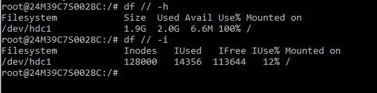

    thank you soo much for your help and support. I hvae managed to follow your instructions and connect via Telnet to my NAs. i then used the code you provided and to the follwoing information back.
    root@24M39C7S0028C:/# df // -h
    Filesystem Size Used Avail Use% Mounted on
    /dev/hdc1 1.9G 2.0G 6.6M 100% /
    root@24M39C7S0028C:/# df // -i
    Filesystem Inodes IUsed IFree IUse% Mounted on
    /dev/hdc1 128000 14356 113644 12% /
    also see - attached print screen.
    however, i am not sure how to interprete the above - is this confirming the OS partition is full (100%) - if so, where to from here?
    if you could guid me with future code - or advise future steps - much appreciatd
    thanks steven .
      Yes, this confims that the OS partition is full (only 6.6M left).
      The next step is to figure out where the space is going (and why).
      • Do you have any add-ons installed?
      • Do you use ReadyDLNA?
      ReadyDLNA by default put its cache in the OS partition, but there is an add-on that will move that to the C volume.
      Another possibility is that the logs are simply too big.  So also try
      # df /var/log -h
      and post that info here.
