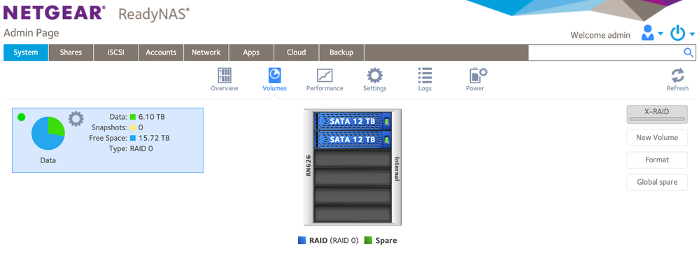

Hi,
I would like to Wipe my HDD and Format all the data and reusing it again
the format button is inactive but the DESTROY is active
if I choose destroy then what next step will I be able to resting it as Raid 0

19 Replies
- StephenBGuru - Experienced User
- Both HDDs?
- Do you want to create a new volume in the NAS? Or reuse the disks in another device?
- Do you have any apps installed on the NAS?
I want to wipe both HDD and reuse it again as Raid 0
in same NAS
but would be different if I'm going to transfer the HDD to another NAS ?
I have one app installed (Plex)
Then begin by uninstalling it. It uses a hidden folder on the data volume, so it will need to be reinstalled after you create a new volume.
After that, use "destroy". You can then format them from the web ui, and create a new volume.
Once that is done, you need to recreate the shares, reinstall plex, and restore your files from a backup.
