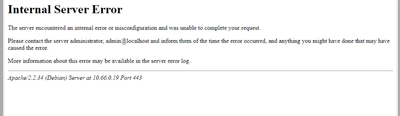

So i forgot my password to get into the readynas (password did not work). I did a os reinstall to reset the password back to default. now when I log in and it asks for the password it seems to work then i get this error.

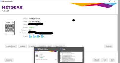

Now when I go to netgear RAIDar and it prompts for the password I try the default and I get this. Hoping someone can help me figure this out!!!

    I came across similar issue i am unbale to connect using putty or web GUI getting below error , i cannot browse share as well
    error message
    error in the logs before this happen , when i enabled ssh access page refreshed then started this issue couple of times reboot still same issue
    please help as we have 3 TB data we don't want to loose no backup at the monent.
    Thanks
    • StephenB's avatar
      StephenB
      Your problem is that you have a full OS partition - that is clear from one of your screen shots.
