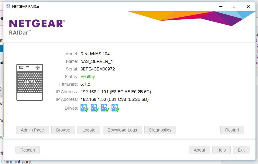

ReadyNAS "Admin Page" is offline
Upgraded to firmware 6.7.5 through the web interface and now the unit is not responing via the browser at all.
SMB share is still working
Tried Rebooting
Tried Reset via reset pin on back and selecting OS Reinstall - same issue
Raidar Diagnostic will not connect, but raidar says unit is healthy !

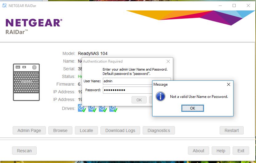

I cannot download the logs because login is not working, I know the password before someone suggests password recovery.

I know the issue is network adapter related because "\\192.168.1.101\folder" is working fine, but  "\\192.168.1.147\folder" comes up with network error do i want to diagnose?

    • mickle026's avatar
      mickle026
      fwbroker responds but wants me to login, that unfortunatelly isn't working.  My correct pawwword just gives "Authorisation Required"
      Its the same with raidar diagnostics, the login isn't working.

        You could try using admin/password, just in case you did an OS reinstall accidentally.

  • Noticed when posting raidar reports my second ip as 192.168.1.50, but it still doesnt work :(
