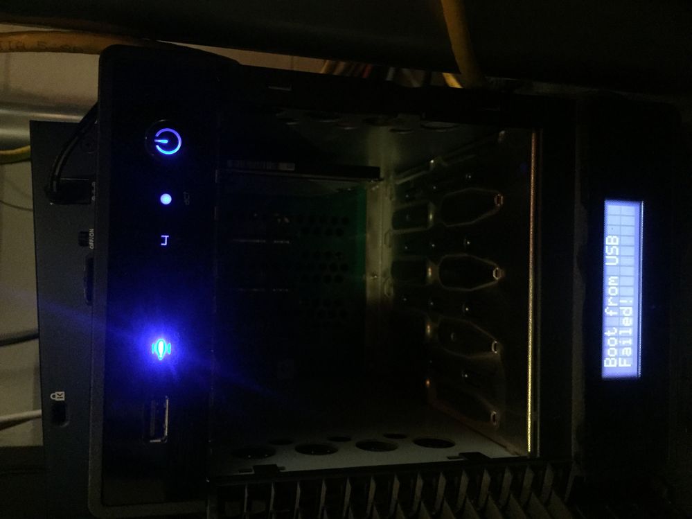

roen1, Can you show the state it's in when trying to boot normally?
- What is printed on the LCD display?
- How long does it take to get to its final state?
- What is the state of each of the LEDs?
- Do any of the buttons respond?

when I boot from usb long and press backup button long time I get in debug mode, when press just untill he tries to boot from usb (usb flickering) i get second photo 'readynas usb recovery' and it shuts down without anything getting fixed.
When booting whithout USB I get 'boot from USB failed' and flickering backup and power button. Only way to shut down is to cut the power.
when booting normallywhen booting from USB
