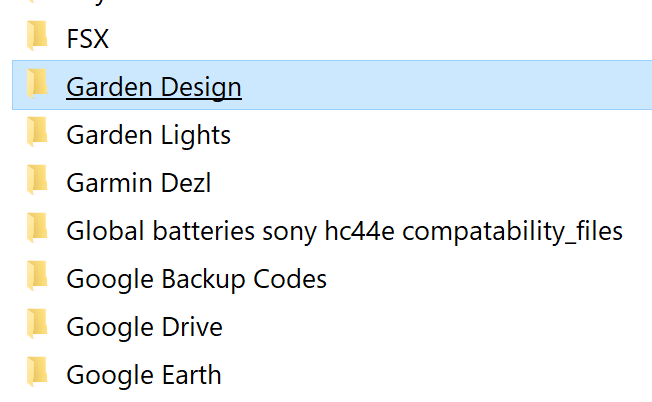

      FSX is the last visible folder I can see - Garden Design has 2 zipped folders in it but I don't see any "Illegal Characters" in it
      and I've unzipped them and looked at those - they see legal. FSX has a zipped and the unzipped version - again nothing that looks illegal there.

        But I'm not very good at inserting image of file explorer - the folder is named in straight English "Garden Lights"

      Thanks Stephen. I can fully access the files and folder through File Explorer via ReadyNas as a network resource and I have also mapped the ReadyNas\Documents to a Z:\ drive. Everything is there.
      I'm accessing the ReadyNas via it's ip address - 192.168.XX.XX then fill in the login request using the admin login.
      Instead of getting to the end of the Documents it stops early after the FSX folder then starts listing files in the top directory.
