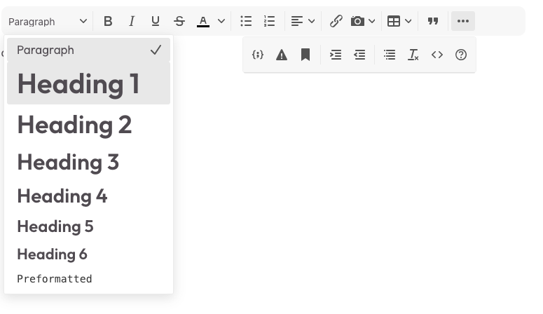

Unrelated aside: why don't I have the option to preformat text like in my original post?
There are some things I like about the new forum software, but there are some aspects that are steps back. You can post feedback here: We Want Your Feedback | NETGEAR Communities But don't expect quick action.
I see the same formatting options in the toolbar in replies as I see in new discussion threads. So I'm not sure what you mean.
I wish they'd put back underlines, and sometimes the strikethroughs were helpful. And there are inconsistencies - PMs have fewer options than forum posts.
I only see 👇

Which is what I see on bothe new discussions and replies. What format options are you looking for????
I just had more options for the initial post that started this thread and expected to be offered the same options for any subsequent post.
I think I was mainly after the Preformatted option as part of the Paragraph dropdown but you don't this for subsequent replies. Anyway, a minor issue that can be worked around, a little jarring but no biggie.
