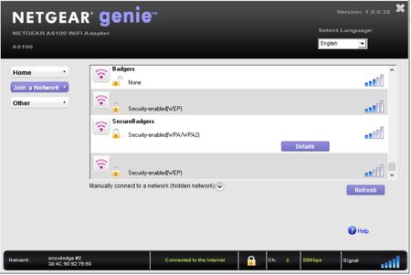

The wifi at my College is protected by a username and password specific to me. After swapping the hard drive on my laptop something went wrong with how I get wifi and I needed a wifi adapter. In the NETGEAR GENIE there is no connect button like there is for the other wifi's. Is there any way that I can connect to this wifi? I have not found any solutions yet. I am running Windows 10 and the driver is fully updated. As seen in below pictures the secure one does not have a connect like the other.2.5KViews0likes3CommentsA6100 takes a few minutes after start up to connect to internet.
