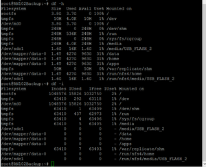

Hello, I recently started getting notifications that my system volume 'root' usage is 100% I've gone through all of the files and it seems the culprit is /dev/md0 I have no add-ons installed, and this NAS is specifically used as a backup of another NAS. It uses ReadyNAS Replicate for backups. Here's the output from df-h and df-i I've already tried commands similar to these: du -csh /var du -csh /var/* And the problem does not seem to be in those directories. Very low usage there. This error started appearing on the day that I got a copy failed error from ReadyNAS Replicate that gave me an Exit Code: 11 (Error in file I/O) Can someone help me fix this?Solved24KViews0likes9CommentsWe Choose ReadyNAS for its Performance - DID Technology #CaseStudy
