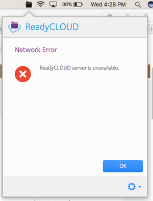

401 TopicsNetwork error on readycloud app
Firmware 6.9 Readycloud app v1.4 When I try to log in via the ReadyCloud App (v1.4, OSX) I get "Network Error. The ReadyCloud server is not available". I can connect via the web portal, can access the admin page, can find the readynas via the RAIDar etc. The desktop app worked up until recently, and I can't figure out what's changed. I've tried logging in with different cridentials, tried reinstalling the app. No change. I set eveything up a while ago and don't remeber what it used to look like. Using the readycloud web app, I don't see my own account under "shared folders", and it won't let me invite my own account to share a folder. I hed to re-add another account that had diasppeared at some point for some reason. I assume that the main account has automatic permission to access all folders? Any thougts on why the app doesn't work? I've wasted a lot of time on this already and it's probably something dumb. Thanks4.4KViews4likes6CommentsHaving ReadyCLOUD problems since 3/30/17?

I've been having a terrible time connecting to our server using the ready cloud desktop app for mac, but starting today i am getting this message. if i log in through the website, everything is working, but this is clearly not. I've reinstalled and restarted my computer. I am so tired of having issues with this. Does anyone have any ideas?12KViews2likes25CommentsReadyCLOUD not working with apps but works from web
