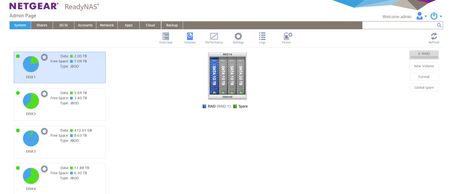

I have 4 x 4Tb drives in my NAS, and all are showing solid blue lights on the physical device. The performance screen in the ReadyNAS app shows green for all 4 drives and performing as expected for temperature etc. But the Volumes screen is odd, as all 4 drives are red in the image of the NAS? Why is it asking me to remove inactive volumes? And should I remove the 10.9TB volume or the other one? My laptop still sees the NAS, and the partitions/folders I created on it, but cannot access the data, coming up with error message saying it cannot reconnect as the local device name is already in use. How do I resolve this as I have a lifetime of photos and other data stored on the NAS (I'm assuming that the data hasn't been lost, I just can't access it?) Many thanks to whoever helps. :)Transfer the hard drive from a failing Readynas 312? Planning for inevitable failure..
