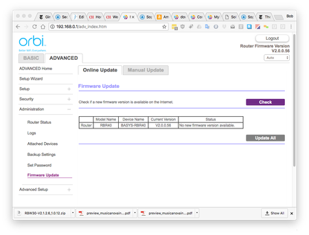

My RBK40 Orbi Router shows up on the Firmware Update page, but my two RBW30 satellites do not show up on the Manual Updates page - though they're both online and working nominally. What's up with that? Enclosed photos: Router homepage showing 2 satellites operating; basic firmware update screen showing router; manual update screen with no satellites displayed.Satellite won't update to 2.1.2.18
