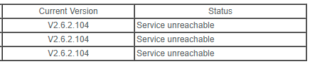

  • Something is up here. Why is the firmware service offline? I should not be forced to downgrade my firmware to solve an issue that is obviously affecting multiple customers.
    Netgear support -- what ist the ETA for resolving this firmware issue? This is simply unaccetpable levels of customer service.

      • Jeeves1925's avatar
        Jeeves1925
        Guide
        I shouldn't have to rebuild everything from scratch. Clearly there is an issue with V2.6.2.104, as there are many complaints about the same issue (i.e., dropping packets, unstable internet, etc.). And then suddenly the online update service is unreachable. Clearly something is up.
        My Solution:
        • First, I downgraded just the RBR20 to V.2.6.1.36 (no reason to downgrade the satellites). This improved my internet connection slightly, but still dropping packets.
        • Second, I downgraded one more time (based on recommendations from other posts) to V.2.3.5.30 which completely resolved the problem. Zero packet loss and internet is now rock solid like it has been for the last year.
        My Conclusion:
        • There is clearly an issue with current firmware versions 2.6.1.36 and higher and Netgear needs to be transparent about the issue and resolve it.
