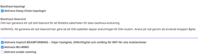

- FURRYe38Guru - Experienced UserDoes disabling Beamforming, MiMo Daisy Chain or fast roaming do anything?
Did you factory reset both router and satellite after upgrading?- Bill____Apprentice

Oh my. This is not what I wanted to read. I was following the other thread, saw that people were largely happy with the new software and finally "upgraded" tonight. Decided to do some additional reading to see whether people are using Beamforming, MU-MIMO and Fast Roaming, but found this. Well, here's to hoping that maybe I'll get lucky.
