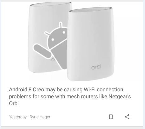

- mm06905Guide
Just seen this yesterday. May be of interest.

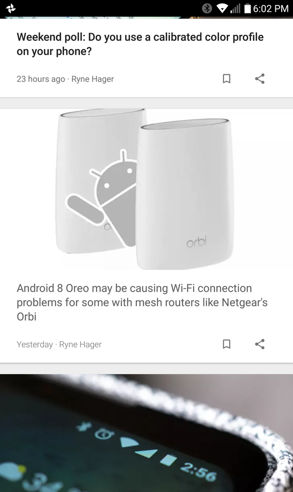

- mm06905Guide
Has anyone seen this
