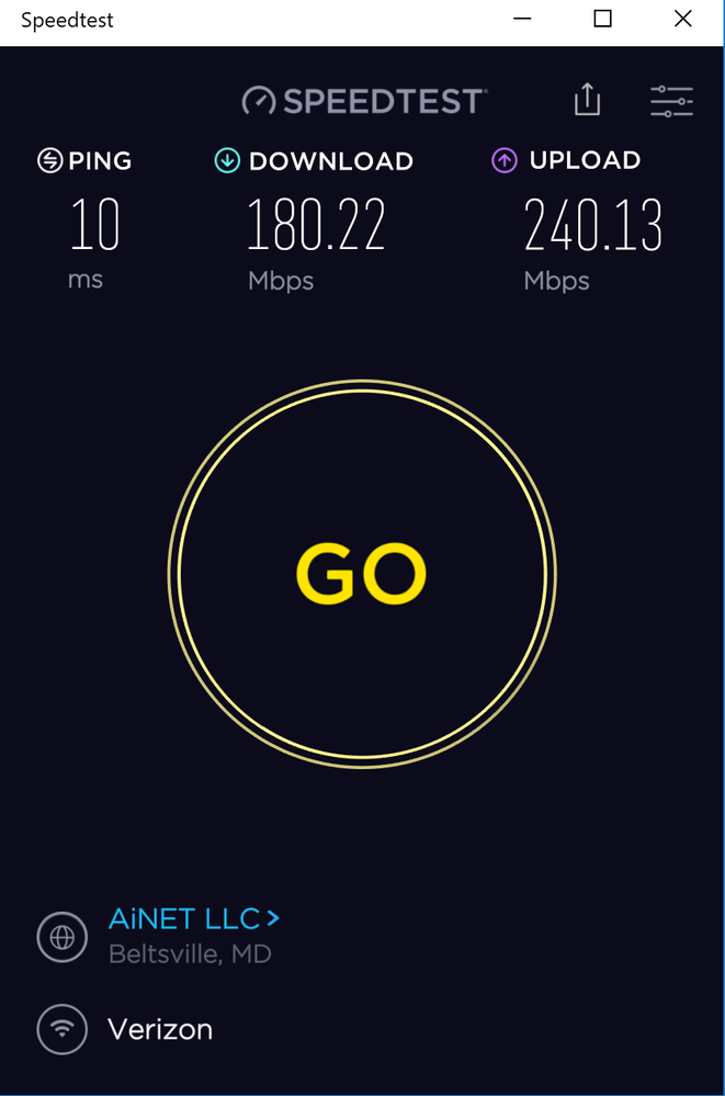

      I have the RBR40, the one with a base router connected to the FIOS router and a plug in satellite. I have the main router connected to the FIOS router as this was the only way the verizon tech told me I could use another router besides theirs but their router sucks. On a 100/100 plan I can only get about 40-50mbps on wifi and with the Orbi Mesh Router, I get anywhere from 80+ wifi. I never use ethernet eventhough I know it's supposed to be faster and that's the best way of getting the best speeds but the problem is that I don't have a ethernet cable log enough to reach my basement where most of my work is done. The Tech put the router there as it is the centerpoint of the house. I know there is a way to turn off the Verizon FIOS wifi but I don't remember how to do it and I'm sure it's conflicting with my Orbi router and like I said, anyone who can help me replace the FIOS router with my Orbi router then I will pay you $50 via paypal for your time. You also have to help me maximize the setting on my Orbi to get me the best connection. If you can do that then I have no problem paying you for your time. With that said, the more devices I have connected to the router will decrease the speed too right? I'm contemplating whether or not to connect everyone's devices to the Orbi router bc I don't want to bog it down even more. Right now I have about 7 devices and if I got rid of the Verizon router I would need to add an additional 5 devices. that would be about 12+ devices. 5 of which is using the satellite and 2 using the Orbi base system then my mom and dad's iphone and ipad are using the FIOS router. The FIOS router is really crap and I can't stand it but the tech at Verizon FIOS won't help me remove the router altogether and told me the only way I could get the Orbi to work is if I tethered it to the FIOS router. Is this true? Does anyone know if this is true or not? Also, will the more devices you have bog down the network speed or will it not affect it at all? Please let me know. Thanks in advance!
      Attached is my most current speedtest using Microsoft Edge on a 2017 Surface Pro i7/8GB/256GB Memory configuration.

        I figured out how to replace my FIOS router with the Orbi Router and the speeds are more in line but crazy fast since I only pay $29.99 for 100/100MBPS up/down. I didn't know that you could just unplug the ethernet cable from the FIOS router and connect it to the Orbi and it would work right away. I thought you had to go through configurations and make a whole bunch of changes but I guess not and I guess Verizon Tech's have been lying to me for over 10 yrs now. First I tried to turn off the WiFi on the FIOS router and I ran a test and it was fast. Then I unplugged the ethernet from the FIOS router and plugged it into the Orbi and viola, instant internet. No configurations or anything. Now I have to give my mom and dad my router password. Will the additional 4 device cause me to slow down even more? I guess I don't have to pay for anyone to show me how to re-route my router so the Orbi would work as my main router. I'm thinking maybe I should get another satellite and put it upstairs so it won't slow the network down. What do you guys think? I will have a total of about 15 devices connected between the Orbi base station and the Sattelite. Do you guys think the two routers I have now are sufficient or should I get another satellite just to be sure?
        Attached is the speed I got sitting right on top of the satellite router that I have right now with 6 devices connected to it.

  • Wired and wireless speeds will be different.
    You won't always get gigabit speed across the Internet, because your data will go across links of varying quality.  Test your connection speed using the official Verizon speed test on a wired laptop or desktop. This keeps the data within the Verizon network.
    Wireless throughput will be less than wired. Orbi has a maximum WiFi link rate of 866 Mbps, so you should expect maximum throughput around 500 Mbps.  I've measured up to 520 Mbps WiFi throughput on my Orbi with an iPhone 7+.

      unless your wired you will never get 1gb/s on a single wireless connection.  that service is designed so multiple devices can have high usage at the same time.   a 1x1 connection commonly found in smart phones and laptops will only get a max of 433 mpbs.  thats is perfect conditions. realistly with a good strong signal you will only see around 250-300. newer apple products have 2x2 and 3x3 availble so it can max out the orbi wireless connection of 866 mbps 2x2.  but you can do this on both the router and satellite at the same time with 4 devices you could reach 1gbps speed.  realistic 2x2 speeds are around 650mb/s.  its not a orbi problem its just how wifi works.  5ghz has very little range esp at high speed.  same room line of sight is required for this.  anything else will slow it down.  hook up ethernet to do a full bandwitch test.  as stated earlier also run the qos speed test again.  if it was run with the old setup it will limit the new setup.
        It's important to understand that "max out" doesn't mean you will get 866 Mbps data throughput for a single client.  For Orbi, 866 is the maximum physical link rate. With any WiFi system, a single client will only achieve a maximum of about 50-65% of the link rate as throughput, under ideal conditions, due to the overhead involved in WiFi. The best throughput I've seen on a 2x2 866 Mbps link is 600 Mbps. That was with a Unifi LR AP and a brand new 2018 Macbook Pro. The same Macbook did 770 Mbps on a 3x3 1300 Mbps AP.

      That's just it! I did a test on my iPhone 8+ and I was getting speeds higher than on my Surface Pro 2017. I do not have a way or connecting to the Orbi router via ethernet nor do I want to. I just want to wake up and have the crap load of money I'm paying for to work as advertised. I got around 400mbps with my iPhone but on my brand new SP 2017 I couldn't get anything above the screenshot that I gave you guys. I'm not a techy person, I love tech-when it works but I know very little about throughput and output etc,. Thanks in advance, I'll try the Verizon Fios speed test but I don't think that'll make a difference bc it's still using the same program. Why would that get me higher speeds? I don't really care about the numbers on the speed test but I do care about how it was functioning and it was not that much faster than the 100/100 plan that I am paying $29.99 for and with that plan, I can upwards of over 100mbps up/down with my Orbi router and that's via wifi and not ethernet. I don't want to connect the Orbi directly to my SP bc I have the main FIOS router setup in the living room as that is the main room in my townhouse and I live in the basement so I have the satellite connected in the basement. It seems to work well when I'm on the 100/100mbps plan but when I swithced to the 1GBPS plan, I barely noticed a difference and I should've noticed a signaficant difference being that it is 10x faster on paper.

    The Orbi theoretically should be able to handle 1000Mb on the WAN to LAN since all RJ45 ports are 1000Mb supporting. The wireless speeds will never see much over 400-500Mbps depending upon wireless client HW and Mfr design.
    Testing of a 50 series RBR has not seen anything near 900Mbps on the WAN to LAN side tests with a wired PC.
