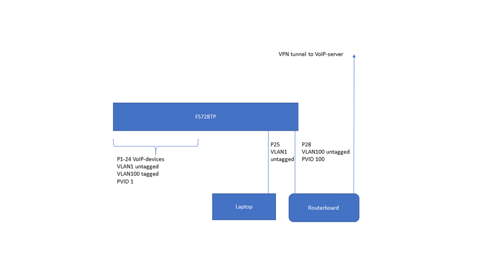

I can not access the web GUI or ping to the ip-address of the switch from my voice network although it is all in the same subnet. If I connect a laptop to the switch I am able to get on the web GUI. The set up is in the picture. The VPN is a client-server sstp tunnel. The server is at the far end at the VoIP-server. The configuration is in the attachment
I can ping from my routerboard the devices on port 1-24 that are in VLAN100, but I can not ping the ip-address of the switch.
The switch will be installed in a remote location and therefor I prefer remote access. I have read 2 other items from last year. Switch was set to factory default before the latest firmware was uploaded en flow control is enabled. What do I need to change to be able to access the switch remotely?

- Hi again, - Okay, so it seems that settings are OK from a VPN perspective. - The issue is that your switch has no Internet access via the management interface. This is a VLAN problem. You are running two VLANs here: 1 and 100. The problem is that your uplink port must trunk both VLANs to the router. Your current port 28 only allows VLAN 100, so that is why VLAN 1 (management VLAN) can't reach the Internet. However, in order for you to trunk (carry) multiple VLANs from the switch to the router, it requires a VLAN aware router. Is your VPN router VLAN aware? Else this is probably not going to work :) - But, there are work-arounds. You could just change the management VLAN of the switch, to VLAN 100 and put it in the same subnet as the VoIP devices. Then it should be work fine accessing it over the VPN. This is likely the easiest for you if you are unfamiliar with VLANs and routing of VLANs! You just need to remember to connect to VLAN 100 if you then want to access the switch GUI locally, on-site. - Thanks

- HopchenProdigyHi LordRob From what you explain it sounds like you are using the same subnet on each side of the VPN? If your remote VPN network and the local network has the same IP subnet, then you will not be able to communicate between them :) If you are using VPN, you must to ensure that each side has a unique private subnet. It works for the VLAN 100 machines, as they are likely in a different subnet? The switch itself is in network: 172.18.2.0 /24. What is the subnet of your remote VPN network? Cheers - LordRobAspirantHi, The network is different on both sites. The switch is in 172.18.2.0/24. The other site of the network is in 172.17.0.0/16. VoIP devices that are connected with the switch can be pinged. - HopchenProdigyHi again, Okay that is good. Is the VPN configured to also allow subnet 172.18.2.0/24 to talk to subnet 172.17.0.0/16? If so, then that should be OK. However, we are sure that the switch itself has an OK Internet connection? Go to "Maintenance" > "Troubleshooting" > try to ping 8.8.8.8. Does it work? It is of course imperative that the switch management interface itself has Internet connection, else it will never be able to respond to VPN traffic from the remote site. I can see that the switch has a gateway of 172.18.2.254. The switch is definitely able to communicate with that gateway for Internet access?
