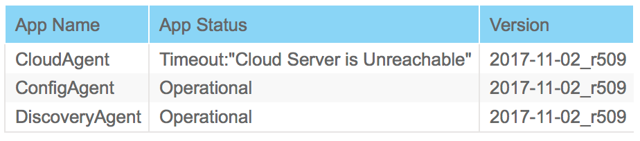

Here goes nothing for my first post:
Purchased these yesterday and they appeared to be the "latest & greatest" and fit a particular need for a client. I got the GC110 setup yesterday and it was connecting to the Cloud just fine. Fast forward to today and neither the GC110 or the GC110P will connect to the cloud. I have reset both at least 3 times and recreated networks and the issue persists. I finally got it to the point that I could see them locally in the Insight app but they are still not connecting to the Cloud. Please see attached photo for issue. I also attached logs from both.

  • I did some additional troubleshooting this morning. I reset both switches back to facotry defaults. Once that was completed, I created a brand new account in the Insight App with a new email. Once that was completed, I then created a new network with the above referenced switches.
    The issue is still present. The log files appear to have the same lines of code and I get to the point where the CloudAgent is "Awaiting Cloud Sign-On". This has persisted for well over a day so I'm assuming that there is something within the Netgear Insight Cloud that is causing this issue.

      • ryanwgregg's avatar
        ryanwgregg
        Please see original post. Both switches have been reset to factory defaults MULTIPLE times. This was done on the latest firmware.
        Be aware that on initial boot, the switches look for the latest firmware and update accordingly before ever adding to the Insight app.
      ryanwgregg
      It appears that the Insight Cloud is now offline. I'm unable to sign in at all.
      I chatted with Support this morning and they thought it was an issue with the Insight Cloud Server. In the middle of our chat, their chat server crashed. So it appears to be an issue on their side and not with the switches. Will update when I know more.
