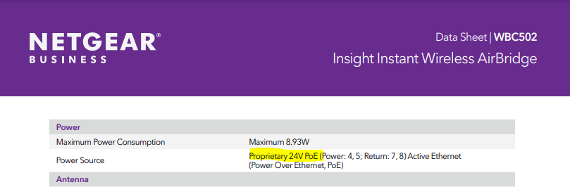

Honestly, Netgear has a very small number of products in their offering, which are indeed passive PoE, too: The WBC502, Insight Instant Wireless AirBridge.
These are identified as a proprietary 24V PoE system - making a clear difference from IEEE standard PoE.
