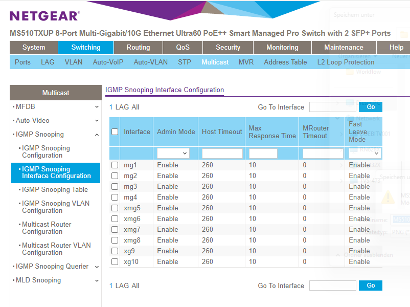

Already the small GS108Tv3 GS110TPv3 GS110TPP Smart Switches for example (User Manual linked for courtesy to the interested readers) do allow enabling/disabling IGMP Multicast (as well as MLD) by interface. Yes, screenshot taken from the bigger and much more powerful MS510TXUP, but hey, you get the idea.
Switching -> Multicast -> IGMP Snooping Interface Configuration
