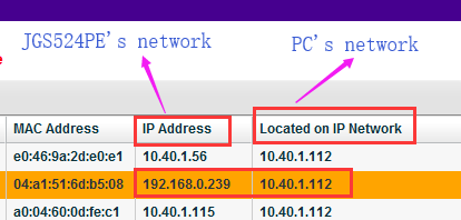

  • Hi Cabinhaven,
    Welcome to NETGEAR community!:smileyhappy:
    Looks like you need to change IP address on PC to match JGS524PE.
    1. Please confirm the IP address of JGS524PE.
    You can get it from utility tools.
    like below:
    2. Then change IP address to same subnet on PC.
    3. Close utility and then open it again to control JGS524PE.
    May the solution help you.:smileyhappy:

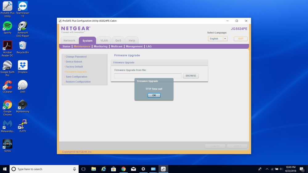

      Thanks,  That does allow the ProSafe Utility to operate again.  But it has the following effects:
      1. My Laptop will now only operate on WIFI while the IP is set to match the ProSafe Utility 192.168.0.239.
      2. when I tried to apply the new firmware 2.01.40 I get the following error:
