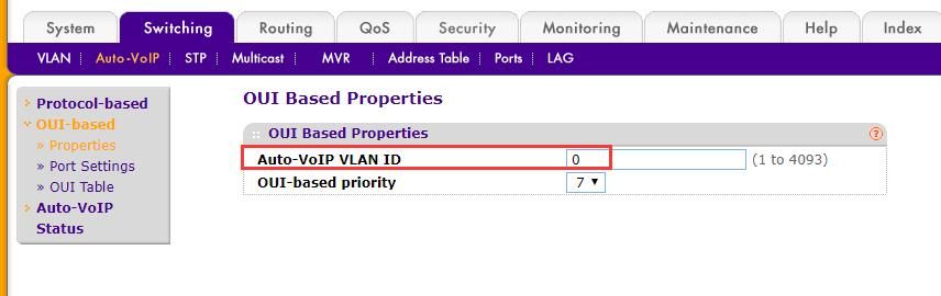

3. Set AutoVoIP VLAN.
Such as: 21

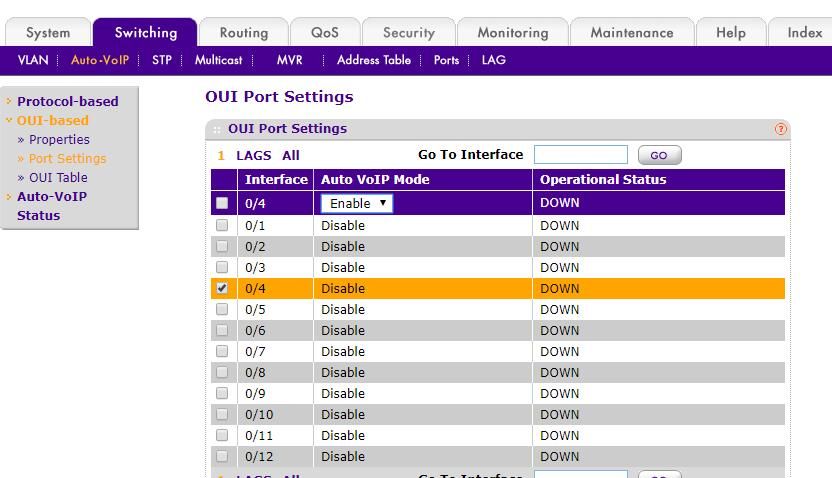

4. Enable OUI base AutoVoIP on port A.

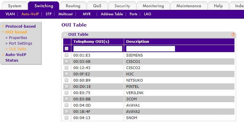

5. Add OUI Mac for your IP phone.(M4100 has some default OUI)

2. On M4100 Switch, you need assign some ports(connect to data PCs) to VLAN 14(untag mode, and PVID=14), and assign some ports(connect to voice phone) to VLAN21(untag mode, and PVID=21). And I suggest you set VLAN 21 to Voice VLAN(Web GUI login the switch, go to 'Switching'-->'Auto-VoIP'-->'OUI-based').
