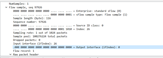

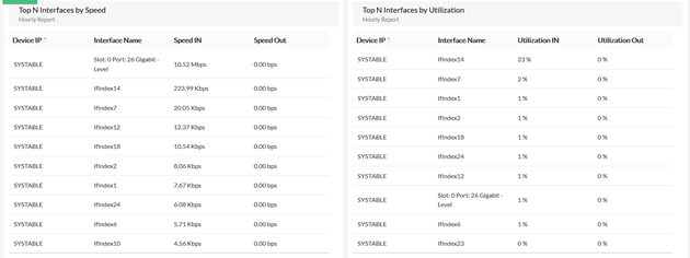

this is traffic utilization my interfaces as you can see there is no speed out / utilization out

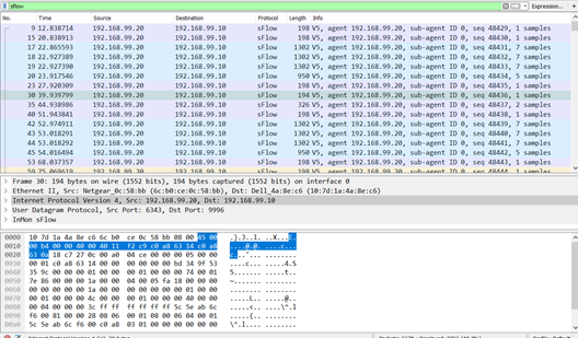

and in Wireshark, I observed that all flow packets have same output interface index which is 0
all out traffic is aggregating and going through ifindex0.

    The 'Input Interface(ifIndex)' value will mapping to your switch interface that forwarding the packet. So could you please check if the ifIndex value is correct? In your wireshard packet, the 'Input Interface' value is 26.
