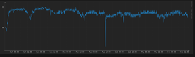

I`m having restarts quite often - twice a day or one restart in 2-3 days. The restarting unit is the backup one, (the restarting unit is allways the warmer one). It becomes unstable when reaching 64-65C. The fans duty levels are constant and I haven`t seen it changing above 27%,(mboard about 5200 rpm, PSU 4600 rpm), but the switch is burning up.

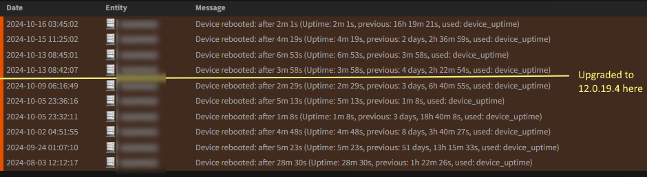

- ahurleyAspirantDid you manage to resolve this issue?
I have several M4300-24x stacked, and I’m facing an issue where two units in the stack will reboot at the same time.
As per your previous post one of these units runs at 65 degrees (the other one is around 55).
