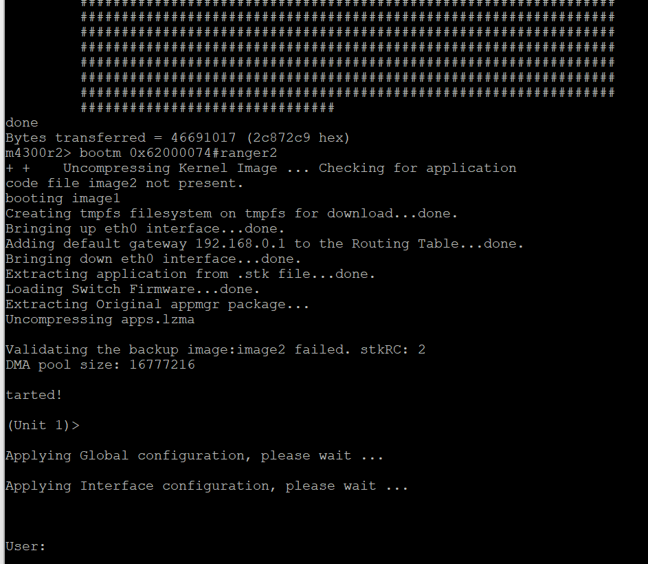

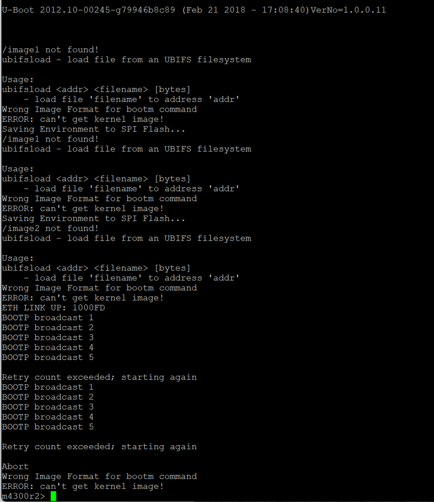

However if I reboot and don't have the TFPD server running it just goes to the in a loop until I interrupt M4300> prompt and it is unusable.
The first part is the boot after TPFP - the second part is when I disconnect the TFTP cable.
My guess is I have to tell it to stop trying to boot from the TFTP or fix an image or something.
I reboot after it loads properly but turn off the TFTP server but it looks like it isn't using the onboard config.
Reboot without TFTP server

  • OK - I don't know what I'm doing but I finally got it to normal.
    I booted it off the tftp
    Then from the console I went to enable
    then I went to clear config
    rebooted it and now the GUI shows the firmware and I was able to upload to image2 using the gui.
    Thought I'd post in case anyone else happened to come across this same situation.
