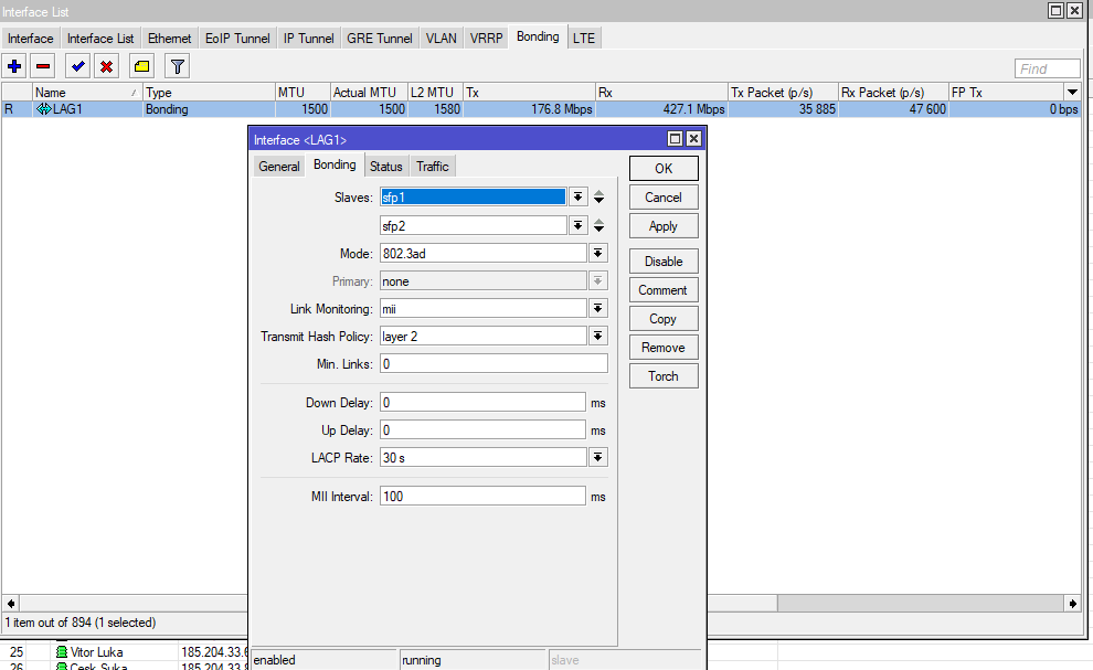

After i configured sfp1 and sfp2 to bondig 802.3ad and in Netgear sfp45 and sfp46 sometimes it show in one interface upload and other interface download, and does not make mt link to gbps, i have tested and is only 1gbps.

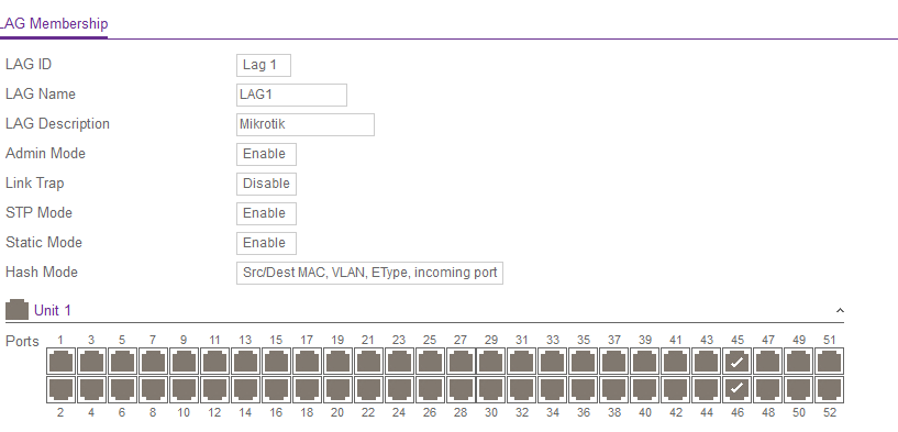

As you see in netgear photo i have checked port 45 and 46,

Im getting confused for configurations on l2 l3 and srcmac dstmac vlan in netgear and mikrotik, is anything wrong in configuration?

Config is for the transmit policy by switch only.
- AGJECAJAspirantVlan500 is configured on LAG1 in mikrotik and LAG1 in Netgear
