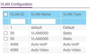

Hello, 'I have a new GS752TPv2 switch. I am hooked up to my Fios router. I was able to change my switch's IP address and wanted to play around with VLANS. I added 2 VLANS (50 & 90). My local network...

One way of accessing the VLANs you created is by untagging a port and setting its PVID with that VLAN, since the switch doesn't have a DHCP server, you'll have to set a static IP address on your computer.
What's the device connected to port 47?

I think I'm with you. The switch is transparent when it comes to DHCP. So the IP range will need to come from the router? I have a sophisticated router at work. At home I have a simple Fios router that does not support VLANS. Port 47 is the laptop I am using. I do have a desktop nearby. If I set a static IP on one of those VLANS to my desktop I should be able to ping it from my laptop if it's on the same VLAN. I switched my laptop and I am able to ping the switch GUI at 90.1. That makes me think everything is working. What I am missing is the DHCP server functionality. When should I tag and untag ports?

Usually, you tag ports if they are connected to another switch or any device that recognizes 802.1Q tags where you want multiple VLANs to pass through it and then untag ports if these are end devices such as computers, printers, and such.

I fired up my desktop and put it on port #47 on VLAN 90. I gave it a static IP address of 192.168.90.69 subnet of 255.255.255.0 and a default gateway of 192.168.9.1. It can ping and access the switch GUI but I am getting a no internet access globe icon and cannot access the internet.
Also, when I go to the default VLAN in VLAN membership and try to leave port #47 blank I get an error that says "Error! Management access will be lost on MGMT VLAN configuration" Is that basically telling me that if I remove access to that port from the default VLAN I won't be able to access the GUI?
