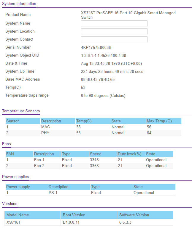

I actually have an XS716T but that model didn't appear in the drop-down list or models.

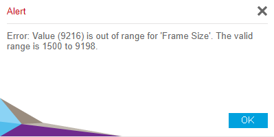

I am looking at Configuring jumbo frames on NETGEAR ProSAFE switches . It shows to set a jumbo frame MTU size of 9216. When I try to set that value on my XS716T with firmware 6.6.3.3, I get an error popup that says 9216 is out of range and the valid values are from 1500 to 9198.MTU size error
I assume I need to use 9198 as my MTU value for jumbo frames?
If the instructions say to use 9216, why is 9216 an invalid value?
Why is my model XS716T not in the drop-down list?
XS716T

  • The maximum frame size depends on the switch design and SoC in place. The XS708T, XS716T, XS728T, XS748T Data Sheet does (somewhat lazy) talk of Jumbo frame support "Up to 9K packet size" for the XS708T and the XS716T, and "Up to 10K packet size" for the XS728T and the XS748T (which don't have an ability to configure the max frame size per port).
    The 9216 example (as shown on a top of the line witch with 12k frame support) is - while common - kind of a randomly chosen number to include whatever padding and the like.
    bradleyv or LaurentMa can you shed some light about the slightly uncommon smaller 9198 here? An exact number on the data shet would make things clear, too.
