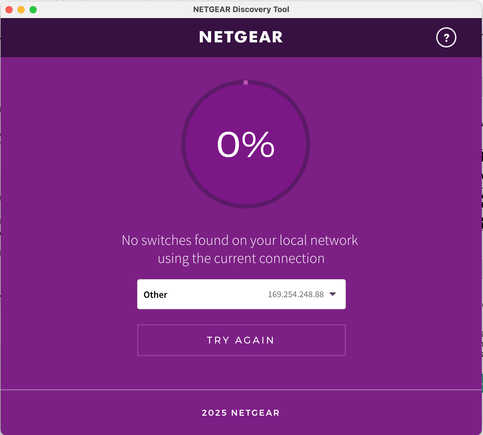

Cannot access GS110TPP after reset
I purchased a used GS110TPP which I need for its PoE features and performed a factory reset by pressing the reset button on the front panel for more than 5 seconds. I expected to be able to access th...

I did try the Netgear Discovery Tool, but it didn't find any device either, and it also showed the 169.254.x.x address on my NIC.
The 169 address on your NIC is expected, since the switch doesn't have an dhcp server in it.
Did you try connecting the switch to your router? Then check the attached device list in the router config.
I believe the discovery method uses ethernet broadcast, so you might also need to disable any firewall/internet security software running on the PC.

StephenB wrote:Maybe try the Netgear Discovery Tool, and see what IP address it returns.
StephenB wrote:The hardware factory reset is described on page 21 of the hardware manual:
https://www.downloads.netgear.com/files/GDC/GS108Tv3/GS108Tv3_GS110TPv3_GS110TPP_HIG_EN.pdf
Are you seeing the power LED turn yellow turing the reset process?
For some reason I missed this page 21. Thanks. It says:
- 0-5 seconds: power cycle (reboot)
- 5-10 seconds: factory reset, but keep registration
- 10+ seconds: factory reset and loose registration
I tried all three variants. The power button did light yellow(-ish).
But still the same behavior after each reboot/reset (169.254.x.x address).
Thanks anyways!

jo-br wrote:I did try the Netgear Discovery Tool, but it didn't find any device either, and it also showed the 169.254.x.x address on my NIC.
- schumakuJul 19, 2025Guru - Experienced User
To be correct, it's an IPv4 broadcast, requiring the computer and the switch -must- be in the same IPv4 subnet.
This is different from the legacy ProSAFE Plus Utility, making use of an Ethernet L2 Broadcast using the legacy Netgear Switch Discovery Protocol (NSDP).
Worth noting, the Netgear Insight App does still contain the NSDP code, and continues to be able discovering many Netgear Plus switches (but without any other App functionality, it just allows to see the switch IP and call the mobile Web browser - what if course requires the mobile and the switch to be in the same IPv4 subnet again.
- StephenBJul 19, 2025Guru - Experienced User
Good to know, thx for chiming in.
